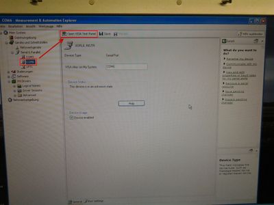

My Hardware is a I-7563 ( RS-485) or a I-7561 ( RS-232/422/485) I checked it with both, but it doesn't work.
The device manager says everything ok. I made a lot of screenshots, so you can see.
Using the Measurement&Automation the red crosses are away but it still doesn't work.
I open the VISA Test Panel.
In the category "I/O" i didn't know which I have to select under "Select or enter command" so I test everything. The results were the same. As you can see in the pictures.
Write: no error
read: error
LabView still doesn't work.
