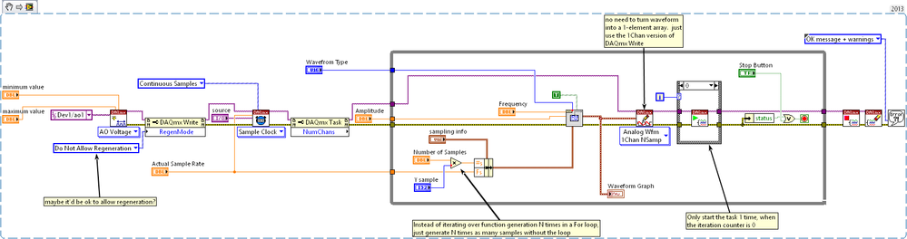

In addition to the good advice from Tom, I made a couple mods and comments in place in your code -- the pic will save me from typing 1000 words.
-Kevin P

Thanks for your correction! Yes, it works well according to your suggestion. But in my application, xy scanning is conducted by two axis galvo mirrors, so, I need to  put 'duplicate' the vi. Error 50103 occurred while error 200290 came again when I used two channel. What should I do to solve this?
p.s Should I use Nchan version of DAQmx Write when I use two channels?
Mei

It'll be more productive (at least initially) to change the task configuration to "allow regeneration" while doing Continuous sampling OR change to Finite sampling.
    Either way, you probably need to first troubleshoot your algorithm that generates the 2 channels of data you want to generate via AO.  It'll be important that both channels have the same # points when they're part of the same task.  And the timing of how they vary relative to one another needs to be correct.  It isn't clear that you've got that part worked out yet.  It's pretty easy to make a subvi out of this signal generation and to put a waveform graph on the front panel.  That'll be a *huge* help in refining your algorithm.
-Kevin P
