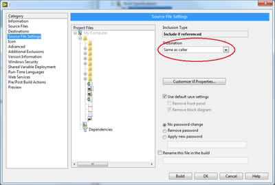

Did you include all dependent files with expected location when you create application?
