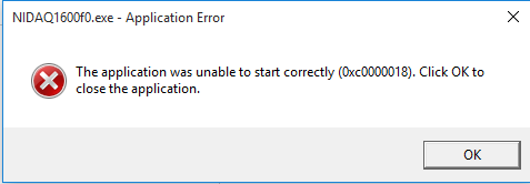

I have LabView 2016 on my computer, which is only compatible to DAQmx 16, and I downloaded DAQmx 16 from official site, but the error below came out when I double click the DAQmx 16. Can any help me install this DAQmx 16. Thank you so much.

sorry for confusion, it's the DAQmx 16 installer, so it' should be "installing" instead of "running".

I have LabView 2016 on my computer, which is only compatible to DAQmx 16, and I downloaded DAQmx 16 installer from official site, but the error below came out when I double click the it. Can any help me install this DAQmx 16. Thank you so much.Untitled.png

I have the same problem. Have you found a solution?
Message 7 of 9
(5,144 Views)
Nevermind. I have found the solution myself.
In my case I used NI Update Service to install DAQmx 16 and it went without problems. I couldn't install it from the file alone.

this seems to be a Microsoft Issue, try the following:
  1. Press Win+R and type regedit
  2. Go to HKEY_LOCAL_MACHINE\SOFTWARE\Wow6432Node\­Microsoft\WindowsNT\CurrentVersion\Windo­­ws
  3. Than search for APPINIT_DLLS and delete the default value
  4. Reboot
Source: Fixing "the application was unable to start correctly (0xc0000018)" in Windows - gHacks Tech News
http://www.ghacks.net/2015/10/16/fixing-the-application-was-unable-to-start-correctly-0xc0000018-in-...
