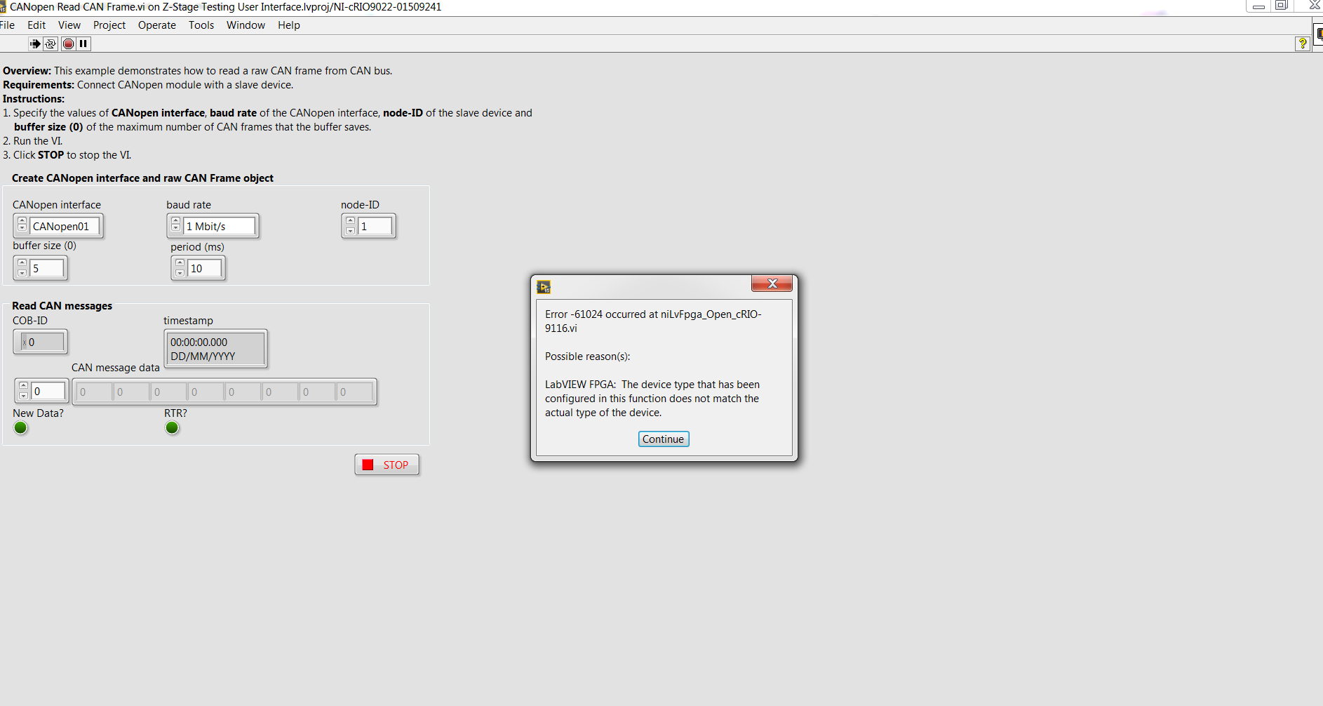

Update, I have managed to get the hardware communicating and it works in the test panel. I am trying to address the harwdare from code usign teh LabVIEW example now but I get the following error, despite all settings being correct in terms of baud rate and addreessing

Have you read getting started with CompactRIO CANopen help document? It will save you lot of headache. In Windows search bar look for NI-Industrial Communications for CANopen Help document.
In Content tab go to Getting Started with CompactRIO.
You have probably went over first few steps but read step 4 and beyond
OR
Go over NI CANopen for CRIO.lvproj very closely. Open "CANopen cRIO FPGA Compile Instruction.vi" fpga vi front panel for instructions.
Basically what you  need to do is to compile a blank fpga vi and deploy it to your cRIO-9022. You then need to go the VIs you are  using and reference this newly compiled bitfile using Open FPGA Reference.vi.
From your screenshot It looks like you just copied VIs and hit run. Notice your error indicates that error occured at ".....cRIO-9116" which is cRIO that was used to build this example project. You  have to reconfigure the project to use with your cRIO 9022.
I hope this helps
