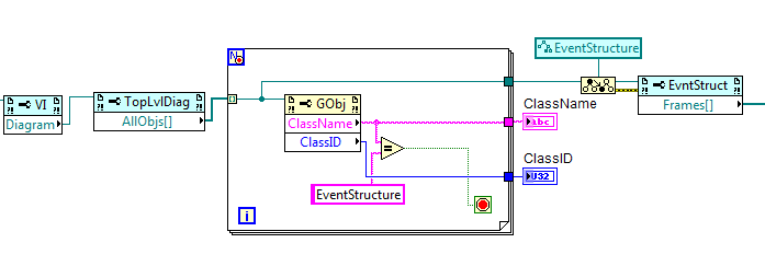

Hi all,
I am actually having some ten VIs which has event structures with nearly 50 cases each. All those events on creating had the "Lock Front Panel" check box being True. I want to make that Boolean False in all the cases for some UI handling. I thought of writing a Scripting VI to modify the property but I was able to proceed only till the frames in the property node heirarchy and was not able to get the properties which defines a particular event. Does anyone had already tried this or Have a solution ?  The below image is my progress. Event Sturcutre Scripting.PNG

I also couldn't find an answer for you but if you are using scripting to look for an object (Event Structure in this case) it is usually a lot easier to use the Traverse for GObjects VI.
https://www.ni.com/docs/en-US/bundle/labview-api-ref/page/vi-lib/utility/traverseref-llb/traverse-fo...
I'm not surprised there is no property under frames for this because Frames[ ] is a proprety of Multiframe Structures and most cannot lock the front panel.  I looked through the class browser and found a Event Locks Panel property for a user registered event but nothing equivalent for an event structure.  This may be something that you cannot do but I would be very interested to know if this can be done.

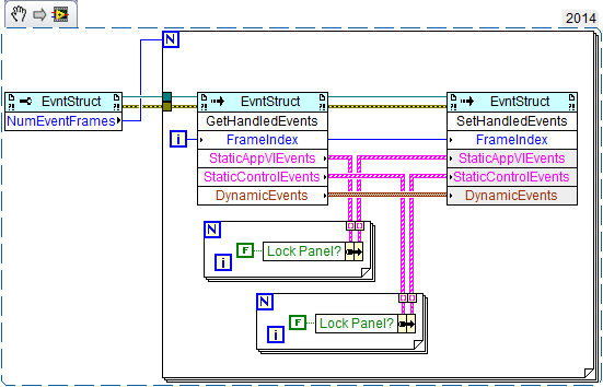

Accepted by topic author Sarath_Kumar.T.G
Message 6 of 9
(4,844 Views)
Thank you so much for giving me the solution.
