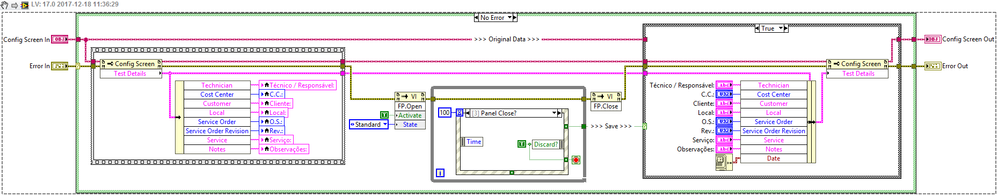

I've been experiencing a strange behavior in LabVIEW 17.0f2. I have a few UI VIs with event structures within them to handle button clicks, updating fields due to change in other fields etc. Here's a simple example in which the user can change a few text and numeric fields stored in the class:
The odd thing is that these VIs cause LabVIEW to light up the yellow warning exclamation, and clicking on that one provides an empty warnings list:
I have already tried to copy and paste diagrams that cause these errors into empty VIs, and making new VIs from scratch, but they end up the same. And the only thing they have in common is that they're all from the same class, and all have an event structure within them.
So, does someone have any idea what these warnings are warning about, and how to solve the issue?

Can not speak to the warning that are not listed but VI Anayzer may tell you what it thinks could be fixed.

I had tried that already a few. It gave me a few suggestions on how to improve the VIs but nothing that solved the empty warning to go away.
One thing that did happen in the last few days though was LabVIEW crashing and failing to compile the code due to messed up propagation of changes to typedefs and class objects, but I fixed those and the code compiles and runs normally. No idea whether the two things are related too.

But as it stands now... you may be looking at a bug and to get a bug fixed we need an example that they can work to fix. How small can you make your example and still get the warning?

You can try deleting different sections of the code to see what LabVIEW doesn't like. You might want to start by removing the class accessors. I've had some strange errors where the accessor output on the property node doesn't match the method which led to an error like this.
