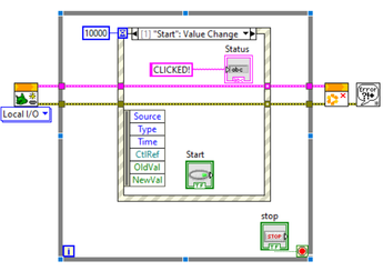

Hi, I'm trying to run a simple VI on LabVIEW using LINX on Beaglebone Black. I have an event structure that returns the string "CLICKED!", activated by a start button, inside a while loop.
But I don't know why the Start button (switch when pressed) never activates the event structure, the data is stuck at its borders.
I would be thankful for any help.

The Start button works OK for me.  But the Stop button behavior is quite poor.
Take a look at my fix.

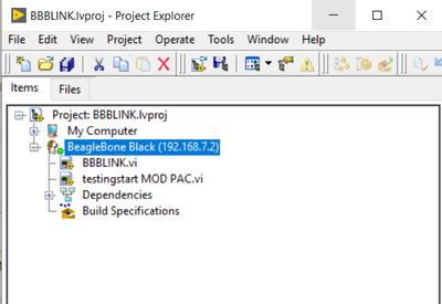

Thanks for the answer. The fix VI generally works when I open it directly as a file on LabVIEW.
But the same problem persists when I open it in the project to which the Beaglebone Black is connected.
(2,140 Views)
The LabVIEW engine on an PI or BBB does not have a visible front panel.
The code is designed to run headless. So most functions regarding user interface do not work on these targets.

You can only use the event structure with user events.
See Event Structure Support in LabVIEW Real-Time
