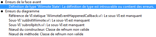

Hi CIML,
Could you attached too the Wiimote State.ctl and Wiimote's VI please ?
They appear to be missing when opening it under LabVIEW 2012 :
Thanks in advance,
