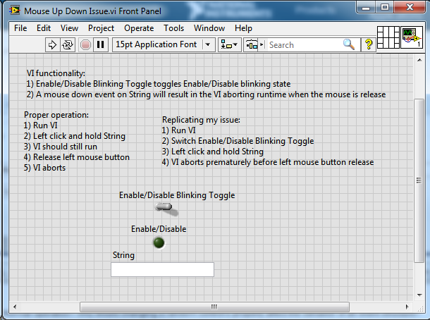

Is the attached VI normal operation? Why would changing a random control's property affect the behavior of an event structure?

DON'T  DON'T  DON'T ever use an event structure inside an event structure.
Read Caveats and Recommendations when Using Events in LabVIEW
What saved you from locking up the VI hard was that you unchecked the Lock Front Panel setting on your event cases from their default of being checked.
The reason it reacts that way is that the Pane: Mouse Up event is occurring when you go and click on the toggle.  So as soon as you Mouse Down on the string, that inner event structure already as the pane: mouse up event queued up and runs right away.
(Actually, that while loop is pointless because the while loop can only run once.)

What I am trying to accomplish is maintaining my poorly written code from a few years ago without re-writing it. Basically I have an event that adds/deletes/resets user defined commands to a list and I wanted to implement a drag and drop feature (event structure required) inside that same event because all the required references are there. But it looks like I just need to create those references...
I understand what is happening now. Thanks guys.
