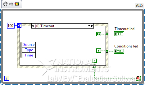

Did I got it right?
PS: This i Snipped - it's a .png file, that you can drag and drop on your BD to insert the code that is presented as functional LV code

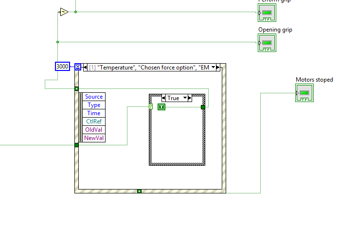

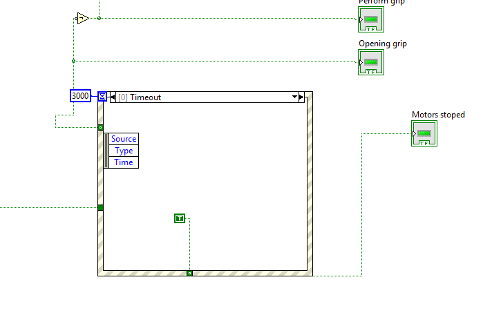

It is something simelar to what you did, it is just a little bit more complicated which I didnt really explain before. I also have a case structure within the even structure and there are some other structures as well between the LED's and the event structure. I think maybe I realise my mistake now, do I need to include all the structures in the time out case as well and just give it a false value to make it work?

You should write false values into other terminals (in general - try avoiding leaving terminals not wired (set as default value))
