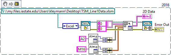

Well, I use the Report Generation Toolkit and avoid ActiveX.  Here's how I would do this:
I open your file as a New Report, using Excel.  I "Get Data" from cell A2 to cell M16 as a 2D array of strings, then I Dispose Report, which closes Excel.  This suggests to me that perhaps there is a Close ActiveX command that you should use instead of Application Quit.
