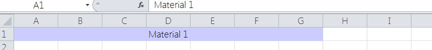

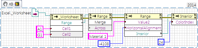

This can be done but needs to use Invoke and property nodes to access the Excel Object Model.
Once you have a reference to the Workseet use the Range Method to define the cells to merge then use the Merge method on the Range object to merge the cells
I have also used the range property to set the value and alignment (I dont know why but -4108 centres the text) and create an interior object in order to set the colour
Result
(5,172 Views)
