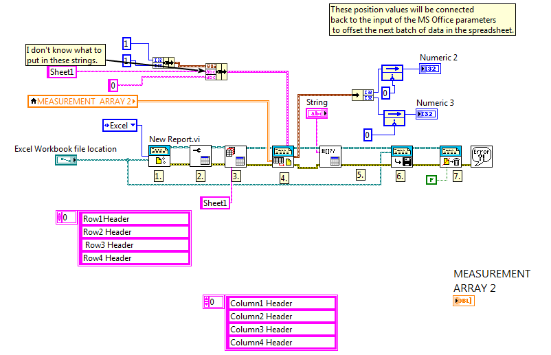

I want to try the Append Table to Report but I don't know how to build MS Office parameters. Help!

It is not clear (to me) why you need to worry about the MS Office Parameters.  Why don't you put together a small VI that shows what you are trying to do (and if you are unsure how to do something, put a Text Label in there that says what you want to do).  Seeing actual code, with inputs, outputs, etc., makes it much easier for "non-mind-readers" such as myself to better understand what you want to do and where you might be going astray.  I can pretty much guarantee one of us will respond within a few hours.

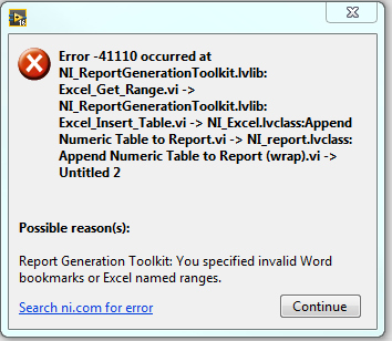

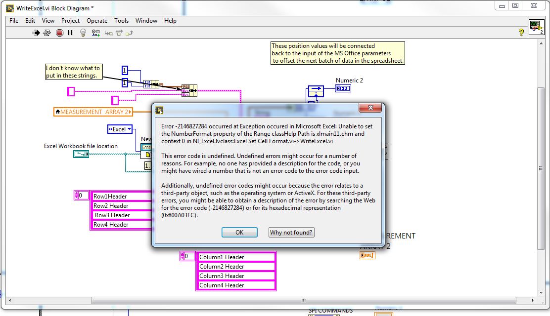

Capture2.PNGOK so I got something for that but I'm getting this error when I run it. I'm including a piece of the VI. In the end, I need to collect data from an instrument, insert it into a spreadsheet, take another set of dat and insert into the same Excel sheet at the new location next to the previous data. I had everything work except the data being rounded.Capture.PNGHere's

Since you provide row and column position connect empty string constants to the name and bookmark inputs.
