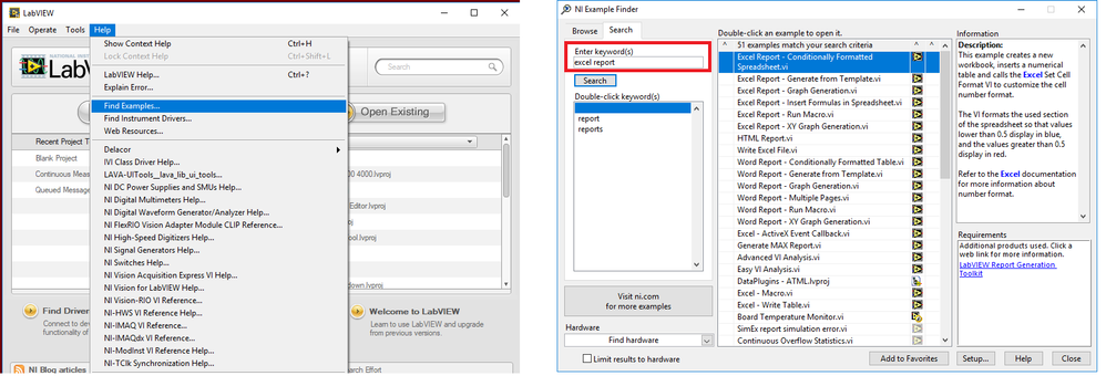

@Mac98 wrote:
do u happen to have the block diagram for me to use excel in labview?
LabVIEW comes with many example for manipulating Excel. To find the examples, go to help > find examples
