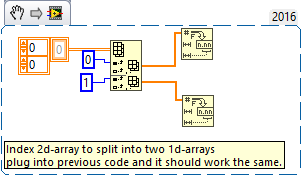

 OJwithPulp that is what i am after but all my measurements are taken and stored in a 2d array. once all measurements are taken i then transfer the data to excel. its when i am send the data from the 2d array to excel that i want to be able to change the font. The vi you posted is for 1d array isnt it?
thanks
Gary
You are correct! However you can index your 2d-array to get the two input 1d-arrays needed to get my code to fit your specifications.

I have 9 rows of data within my array.
I did think about using a macro maybe this would be a quicker approach
Message 12 of 14
(585 Views)
Yeah most likely it would be a much more efficient approach to your problem, I've personally never attempted using a macro so can't help you there. Good luck Smiley Happy
Message 13 of 14
(582 Views)
Thanks for your help guys I've decided to go the Macro route and works perfectly now.
