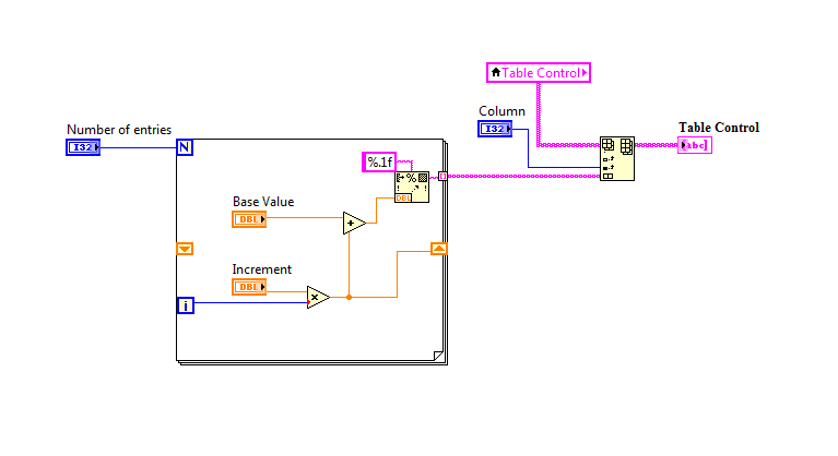

Something like this might help:

Yes , I thought about this but as I want to have a fancy user interface, anyway I found ActiveX for Spreadsheet. They are working fine for me
