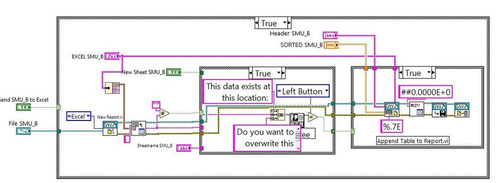

I'm trying to check if I'm overwriting a certain column before I write to it. It reads fine and tells me what's there but when I try to write over the data I get a file open error.Capture.JPG

Most probably the report file has not been closed after previous run here or in another part of the program.
Do you have Close report in false case of the second Case Structure? It is better to move it out to make sure it closes always.

I solved it. I forgot to wire the file location in the Save Report File vi. Doh, I've been fiddling with this for days.

  • Start over!  Do not use any of the current code (which is "broken" in several ways,  and whose purpose and "intended function" cannot easily be deduced from looking (or running) the code!

    1. You are using LabVIEW 2017, so use the correct "Create Report" function from the RGT Palette.  [Did you notice the big red X over the New Report VI in your Block Diagram?  This means the function is "deprecated", i.e. no longer supported, so use something that is supported.]

    3. Decide on the Test you want to run.  Try to make the code for the test "obvious" to the reader (or to yourself).  In your case, you have a Control "Excel SMU_B" without a TypeDef, a Cluster having a Cluster for Excel Position and two Disabled Clusters whose name is written in 7pt type -- it took me a few minutes to figure out what they were!  Don't "hide" important details like this!
