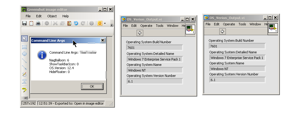

Has anybody else had the data returned by OS.Version be unexpected?  One feature of my built exe started to fail, and digging in there is a section of code that changes based on operating system, therefore I was relying on a propety node (Application class Operating System:Version Number (OS.Version - short name)).
I did not have a problem before, and I don't have a problem with new applications I build, but with this large VI this has gotten incorrect.
Its suddenly returning 12.4 instead of the expected 6.1
I searched my entire registry for instances of 12.4 and found none.  The data returned by "ver" at a command prompt is as expected "Microsoft Windows [Version 6.1.7601]"
Left- existing executable (LV2012), middle LV2015, right LV2012

This morning I tried opening the main VI and doing a Ctrl-Shift-R before the build.  No change.
Then I decided to output all the OS Parameters.  They were ALL different from those reported in the development environment.

I then took the two simple executables (LV2012 and LV2015) that I built yesterday, moved them to the standard install folder of the app, they still worked perfectly.
Then I renamed one of them to the name of my executable and that was the ticket.  If the simple apps have the same name as my troubled application, they report the strange data as above.  I moved them to a different machine and tried the same trick, no dice. so somehow, my laptop has been told to give this particular exe strange information.

Would you care to tell us the name of your application that seems to make this problem? Windows maintains an internal compatibility database where various OS functions such as the OS Version number retrieval will actually outrightly lie to an application based on known incompatibilities of different appliciations. For that Windows uses pointers like the executable name and other characteristics of an executable to determine if it should start to lie about things.
Adding a prefix or postfix to your executable name would most likely be the easiest fix to this.

I have finally succeeded in stopping Windows from lying to my executable!  Specifically, I opened Application Verifier (which got me into the trouble), selected my executable in the list and turned off the Compatibility -> HighVersionLie.
