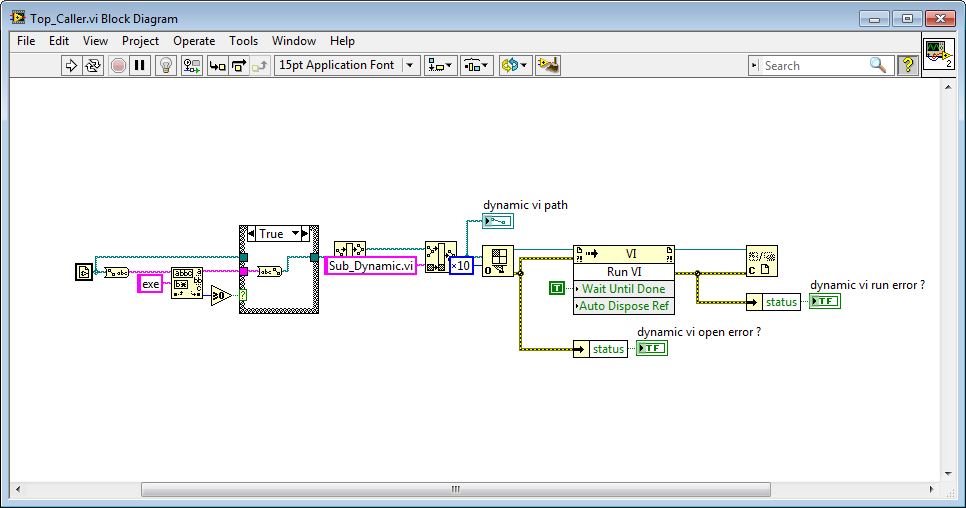

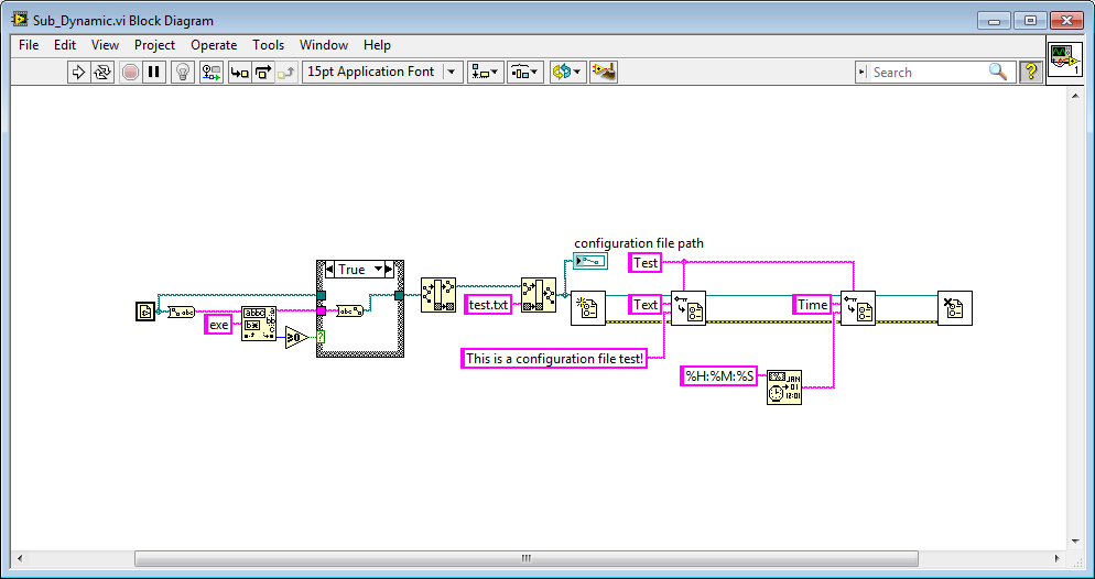

I have a problem when I built a program into exe file.
The source code can run fine, but after turn it into exe file, it doesn't work.
It has a main vi that call sub vi by opening the vi reference, and the sub vi has some functions from NI_LVConfig.lvlib ( Configuration file functions )
Here has two pictures of the demo program.
I searched NI_LVConfig.lvlib in forum and found some topics about this, but I still didnot work out this problem.
I believe this is a problem of vi dependence, that after built, the executable file cannot find the resource of NI_LVConfig.lvlib.

Can you try using application directory as shown inhttp://digital.ni.com/public.nsf/allkb/FD7DE8BC8FFC256C862565F4006BE363

Yeah, it also can get same result by using Current VI Path.

Have you remembered to put your dynamically called subvi into the "always included" in the build specification? As it is called by reference it won't automatically be included.

I tried my demo project, it can work in right way.
I will try my test system.
It is interesting that the dynamic subvi can be called successfully without LVConfig.lvlib functions in use, so I didn't pay attention on included vis.
Thank you very much.Smiley Very Happy

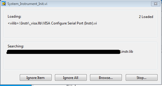

Hi, Lan,
Please kindly help to look at my new problem.
After including all dynamic subvi into the project, the exe file turns to search VISA Configure Serial Port.
I tried to include this vi into project/re-direct the vi, but it helps nothing. The _visa.llb be included into project will affect exe file building due to it has some unexecutable file.
I use this vi in my init function for serial control.
Should I turn to include some other llb file or even other dll file for visa support?
Thank you very much!
Hope can get your kindly help.
BR
Vincent.

It may be that the VISA driver isn't included in the target machine?
You can include it in the "additional installers" page in the installer build.
Ian S
Applications Engineer CLA
National Instruments UK&Ireland
Message 8 of 11
(4,804 Views)
But this problem occurs on my own PC, I didn't run the exe application in test machine cause the exe build problem.
From my previous experience, I think VISA driver doesn't need to build into the exe file but ask user to install NI 488.2.
BR
Vincent
