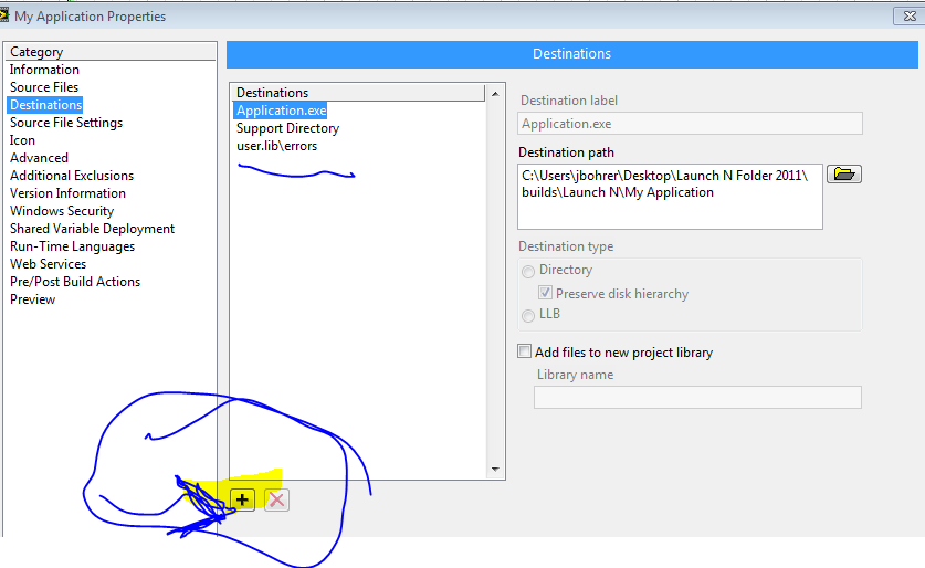

When building an executable (EXE) or shared library (DLL) with the Application Builder, make sure to add the custom error file as a support file (under the Source Files tab). For an executable, the custom error file will be saved in the <executable destination directory>\user.lib\error

Well, you might need to add the destination manually.
