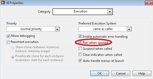

First I marked my VI to "run when opened":

Well.... I got it to work haha.  If you just ignore the document and open the file via the command line, it opens up fine.  I don't know why they tell you to use the LabVIEW.exe command line argument.
"C:\User\Desktop\test.vi"
