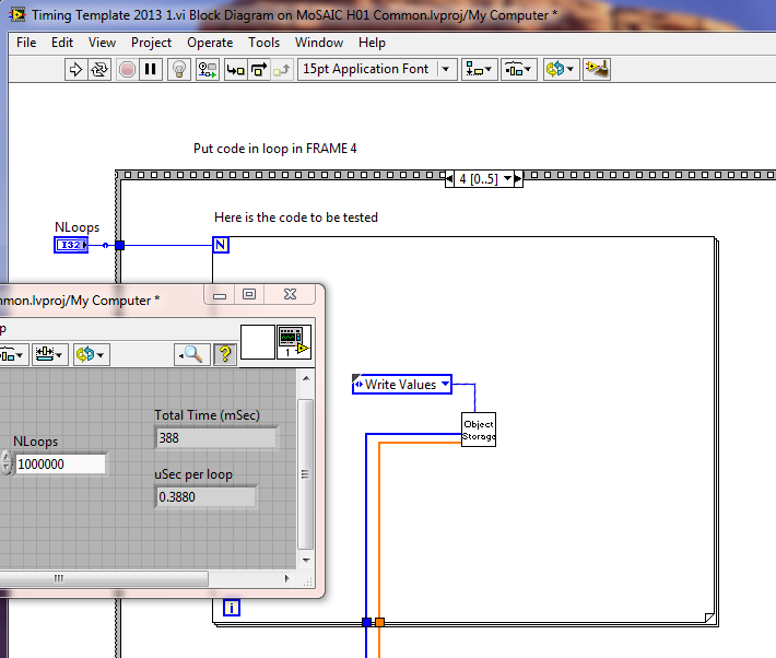

Basically, I time a VI of mine doing a certain operation at 390 nSec +/- 2.  I'm as careful as can be, I have a well-tested template for doing this.
The VI is subroutine priority, but cannot be inline, because it cannot be reentrant.  Fine.

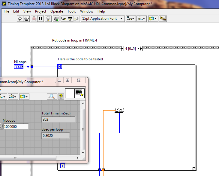

But when I measure the "wrapper" function, it actually measures significantly LESS time!
Namely, 301 nSec +/- 2.
The wrapper is inline subroutine.
So, why does it get faster?  Is this real, or is the optimizer fooling me?
Here is the first test:
And here is the 2nd:

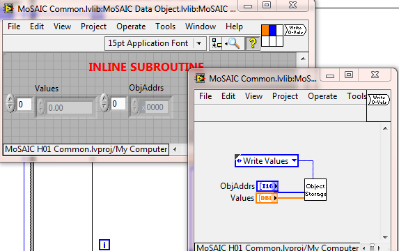

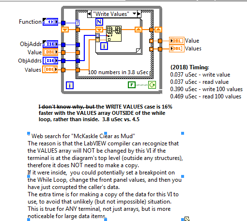

The wrapper code is here:
And the root code is here:
