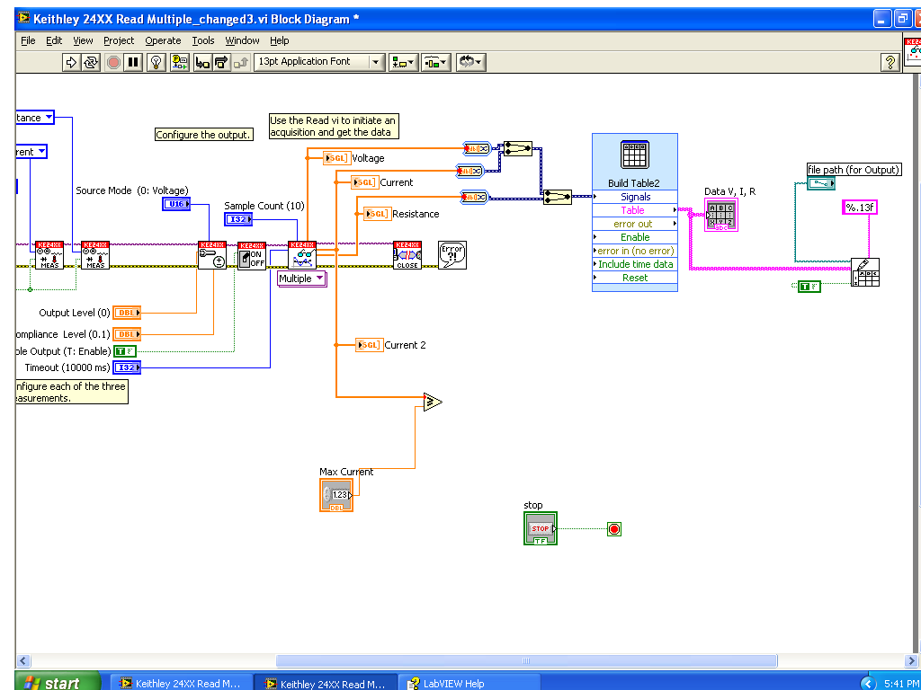

Here is the VI.  I would like to add something to the output of the Greater Or Equal? to stop the VI when the Max Current value is reached.
Thanks for the help.  The problem I had with your suggestion is the stop did not like the array of Booleans.
Here is a screen capture.  The code is inside a while loop.

Ah, oookkaayyy....
What you need is pretty easy  -- it's an And All node.  On the boolean palette, it's the thing that looks like an upside-down A.  Hook up an array of booleans to it, and it will and them all and output the result.
Does that help?
-Matt Bradley
************ kudos always appreciated, but only when deserved **************************
Message 6 of 12
(5,259 Views)
You get an array of booleans, one for each data point in the array. You can do one of two possible operations on it (both from the boolean palette):
insert an "and array elements": The loop will stop if all values meet the condition
insert an "or array elements": The loop will stop it at least one value meets the condition

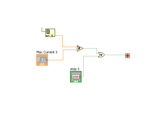

I hope this helps I added a for loop and an or boolean.

or this.....

Accepted by topic author irun26.2
Thanks for the help.  This is the solution I found.
