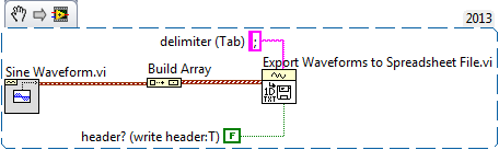

I was able to reproduce this in 2013, the behavior is still present. The key to reproducing it is to make sure you aren't writing a header: i forgot that and tested 2013, 2012, 2009 and 8.5 before realizing I was doing something wrong. The following snippet reproduces this.

Message 9 of 13
(5,005 Views)
Jeff,
Thanks for digging into this. I see it now also.
