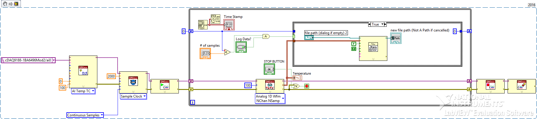

I am writing temperature data into a queue at 100 s/s and 2000Hz from a thermoucouple. I wish to log this data (1 sample in this example, so 50ms of data) when the Log Data pushbutton is pressed, and have a different csv file per test point.
1) I start the program
2) I point the file path to test_a.csv and record one sample. It records it in test_a.csv as expected (as shown in new file path indicator).
3) I now point the file path to test_b.csv and record another sample. Instead of logging the data in test_b.csv, it logs it again in test_a.csv.
4) I hit Log Data again, and only now does it actually record the test point in test_b.csv.
How could I fix this problem?
I attached a simple VI that you should be able to use fairly easily to reproduce the problem I am encountering.
Thanks in advance

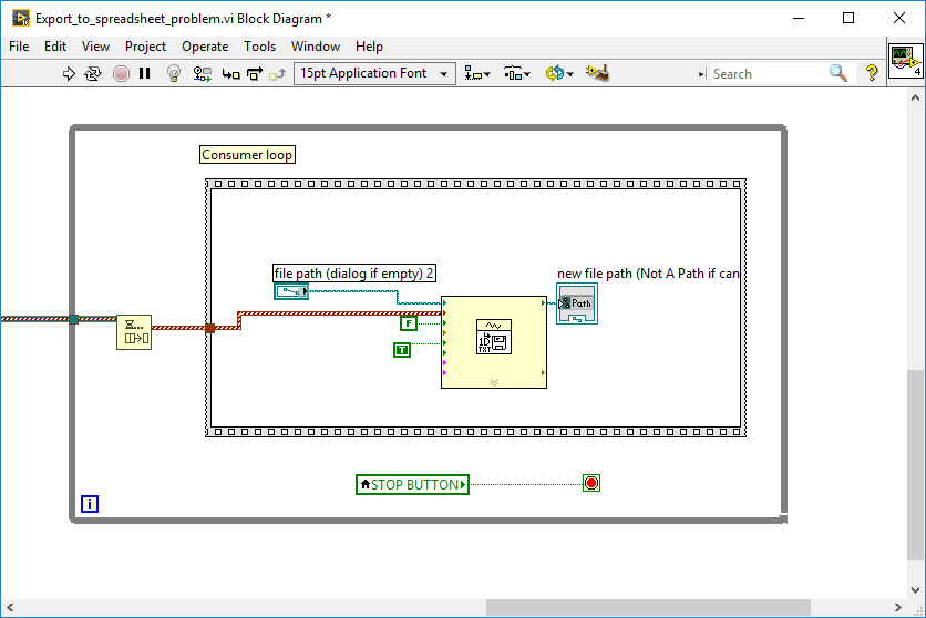

This is definitely much more complicated than it needs to be.  I'm pretty sure you don't need the queue stuff, and I very much doubt that you want two separate loops.
I'm not quite sure this is going to do what you want, but I think the form is correct and this is a good starting point to build from.
Let me know if we're getting close.

In this case the issue is dataflow. The value of the path control is read before it is changed and the loop wait for data to be dequeued. A simple fix is to put a flat sequence around the path control and write to spreadsheet function.
Ben64

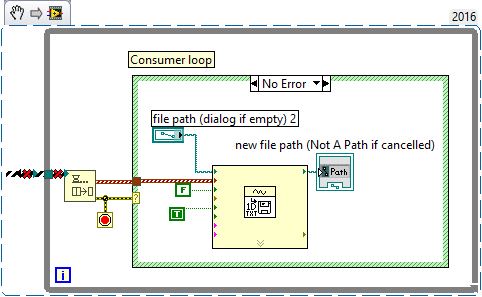

Here is a more standard way:
The error case is empty. When the queue is released the Dequeue Element vi throws an error and the consumer loop is stopped. You don't need a stop local variable and you can set the stop button mechanical action to  Latch When Released. This way the stop button is automatically reset when read.
Ben64
