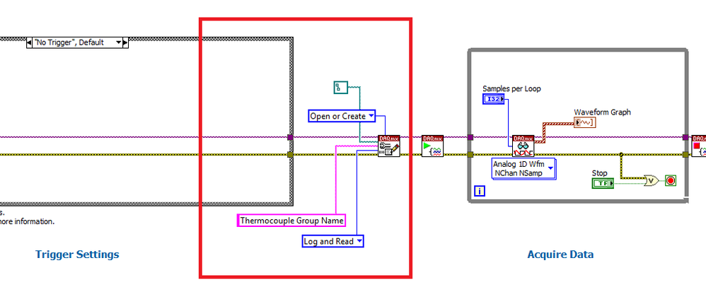

  8. (Optional) Between the Trigger case structure and the Start VI, insert the DAQmx Configure Logging node. Pictured are the inputs and their types - set them as you need (path, group name, opening behaviour). This will log to a .tdms file (which can be opened in Excel using the NI Excel Reader addin: http://www.ni.com/example/27944/en/)

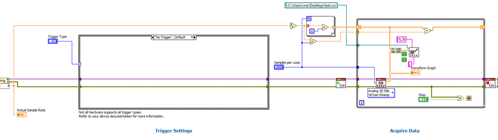

modDAQMXexample.pngAdd the following code:
  1. Reciprocal to the output of the SampClk.Rate (to get dt)
  2. Move "Samples per Loop" outside of the While loop (this prevents changing the size during running, but that should be fine?)
  3. For loop before the While loop, N wired to Samples per Loop, containing multiplication of 1/sample rate with i (generate a list of times starting at 0)
  4. Outside the For loop, multiply Samples per loop with 1/sample rate to get loop iteration time.
  5. Wire the array output of the For loop to a Shift Register on the While loop. Pass the scalar value (from step 4) to a tunnel (not shift register) on the While loop.
  6. Add the two wires and wire to the other side of the SR.
  7. Place Build Array inside the While loop. Right click on it and choose "Concatenate Inputs". Drag it down to create 2 inputs.
  8. Connect the thick orange wire (array of times) to the top input of Build Array. Branch the wire BEFORE the Add node.
  9. Select the dropdown box under the DAQmx Read, and choose Analog > Multiple Channels > Multiple Samples > 2D DBL (note the graph updates automatically)
  10. Connect this double-orange wire to the second input of Build Array.
  11. Wire the output of the Build Array node to the 2D Data input of "Write Delimited Spreadsheet". Right click on each of Path, transpose?, append to file? and delimiter and choose to create constants.
  12. Make the booleans True, the delimiter "," (without quotation marks), and the path whatever you want.
  13. Optionally create a constant for the "format", and increase the number to have more decimal places. Note that thermocouples are not very accurate, so you might be just storing more noise.
  14. ???
  15. Success (and step 14 is a joke... you're already done after 13).
Here's an image showing those modifications:
