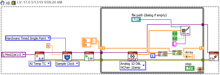

Your array indicator should be 2-D.
You forgot to wire a constant going into the left hand shift register.
And I made a mistake on my program.  The right hand shift register should have come from the 2nd build Array, not straight across.
daqmx-2_BD

I've got some legit data.  But still the main issue stays , I'm not getting them saved to my file directed. Here is the vi.

Mine did get stuff saved to the file, but I found out I needed it was missing the "i" time because I pulled the data from the wrong wire.
Also, you had an extra True constant in there that transposed the array.   When I removed that, the CSV file looked correct when opened in Excel.

I'm looking at your "daqmx latest model.vi", and although you won't get any "time" data because the wire going to the Write Delimited... VI is before you append the "i" value, I don't see another problem.
Try connecting an Error Indicator to the output of the Write Delim VI and see if it give you any clues. Is the file created successfully?

Error indicator has a green tick , the code is 0 and there is nothing in the source column.

Now I've got an error in the indicator , code 43 , saying " open/create/replace file in write spreadsheet string.vi->write delimited spreadsheet(DBL).vi->Daqmx latest model MOD.vi
