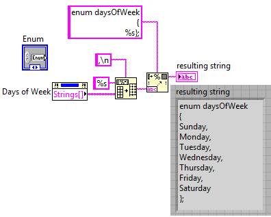

You can export all items from an Enum Control using the "Strings[]" property. The values for enums always begin with zero and increment by one.
Does this help?

Thank you for the suggestion.
I know how to get the string values from the enum in LV itself, just like you have shown.
I also know that I could write a VI that does that and writes it to a file, reformat it as a C enum, etc...
However I think that would be a hack.
For one, the function prototype in the DLL should not be an unsigned int, but an enum, so I would have to manually change the header file or write a script of sorts.
Also, the LV DLL builder should really be smart enough to extract the enum definition and include it as a proper C typedef enum.
So, I guess my question is, is there a way to do this using some settings in the build specifications for the DLL and if not why not?
