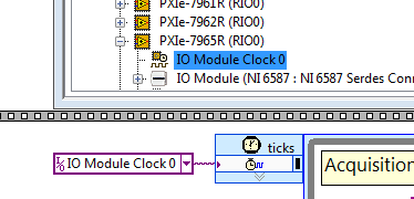

I want to use the external single ended clock on NI 6587.
When configuring NI 6587 adaptor module for ddc simple connector clip, the single ended clock appears as IO module clock 0 from base clock in FPGA.
How to use external single ended clock (SMA clock in) when adaptor module is configured as DDC serdes channel clip or DDC serdes connector? It is not enabled in that case in FPGA base clock.
(3,147 Views)
Can you expand on what you mean by 'it is not enabled in that case'?
You should be able to add the IO Module Clock 0 to the FPGA target and use that as a timing source for a SCTL.
