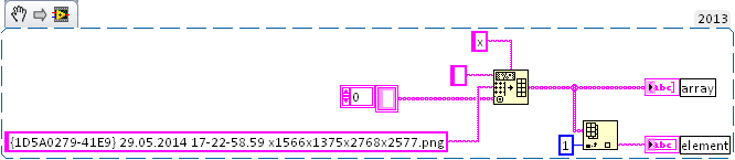

How about using "Spreadsheet string to Array" like this?
(9,396 Views)

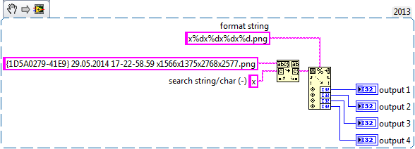

or this way,
btw: I wouldn't use special characters and dots in file names.

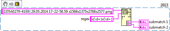

Using regular expression
