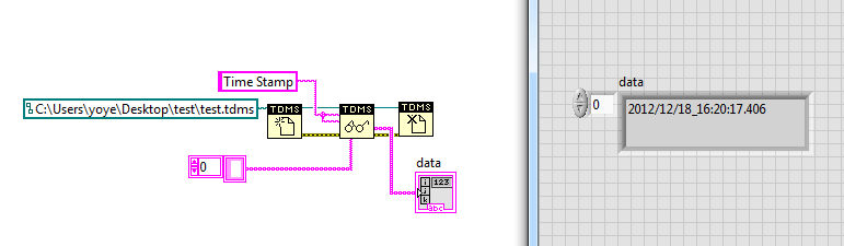

I tried your attached file and it seems everything goes file. I attached the screenshot of my VI here, is that what you want?

I have tried your solution, but it doesn't work for me. Can you upload your vi here i have a look?
It keeps saying error when i run it.

For the node "TDMS Read", it has a terminal called "data type", you have to wire an array of string to it and for the output terminal "data", you also need to wire an array of string to it, so that you can read it out.
Message 6 of 8
(4,702 Views)
ok, oh, I got that now. I think that is the bit that i missed out.
