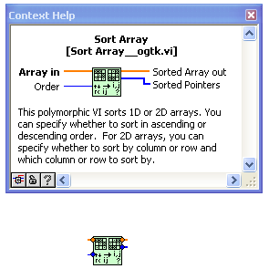

Here is a screen shot of the VI you are looking for, so you can read what it does before you decide to install it or not.  Although it is third party it is well respected and used, I encourage you to consider it.
