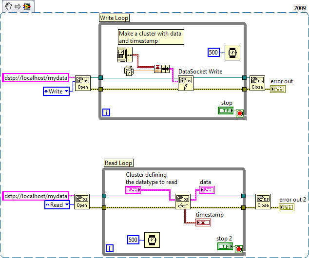

I have implemented live data sharing using LabVIEW DataSocket Server across both intranet and internet. I need to timestamp the data as well. I found out it as one of the inputs in DataSocket Write vi. But at receiver end, I am unable to retrieve it. Can anyone please guide?

The timestamp functionality is not built into the datasocket VIs. However, you can create a custom datatype and include the timestamp information with the data you send. For example, make a cluster with your data and a timestamp, then write that to your datasocket item:
Note that the Timestamp output of the Datasocket Read will only return valid data when you're using it to read from a shared variable. Itranet vs Internet should not matter as long as you provide a valid URL to the Datasocket Open and you have the Datasocker Server running on the server machine.
