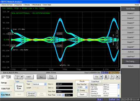

I work in a lab, and we are trying to automate several test benchs to qualify some electronics components. One of these benchs is a data transmission test using the Agilent / Keysight E5071C Virtual Network Analyzer. Among the multiple datas the LabVIEW program needs to acquire, are the Jitter RMS, Jitter p-p and Opening Factor, obtained after generating an Eye/Mask diagram (see picture below):
While I am able to manually generate this diagram by selecting it from the menu and using the "Draw Eye" button, I am unable to find anything relevant to automate this process with the LabVIEW driver provided by NI (attached file). All the other measurements are succesfully performed by the program, except for this one. Hence, I was wondering if anyone ever used this device bundled with this driver, and could provide me some assistance.
