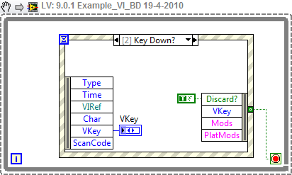

I have no issues with the following code on Windows 7, 32 bit. LabVIEW 2009.1

D'oh!  I forgot to mention that my event is linked to a string control in my program.  The VI snippet posted by TCPlomp works fine and F3 appears to trigger the event.  However, once I modify that snippet to add a string control and link the event to the control then F3 no longer works.
I don't know why the wires are broken in the snippet any why the Event isn't assigned.  So here's the VI also.

The Event case  have no event to trigger off and need redeifining. If F3 is the trigger for a Value change in a string control, why are you not reading the "String" - Value change event?

The event case is properly linked up in the attached VI; however, I don't know why the snippet itself (which is from the attached VI) is broken.  The attached VI is a modification of the snippet that was posted earlier by TCPlomp.  His snippet worked as is, but it showed the same problem when I modified it.
