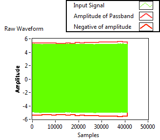

I am using an FFT and inverse FFT as a sort of band pass filter to inspect the vibratory content between a low cutoff frequency and a high cutoff frequency.
My reason for the use of FFT and not other bandpass filtering methods is performance.  I am running filtering and limit checking accels in a control room and my program consumes 25% of the CPU on our higher end workstations.  I am afraid that if I gave our users the ability to specify high ordered digital filters that I'd consume more than 50% of the CPU.  I've found that can't push a windows machine faster than about 50% or latency becomes a problem and I start filling buffers and dropping frames of data.
I have a test signal which is 5g at 30Hz (we think in half peak to peak amplitude, not RMS at my company).  The signal is acquired at ~3145Hz and came from a lab calibrated accel mounted to a calibrated portable shaker.  When I run the test signal through my algorithm, I find it has a compounding error of some sort, like the FFT is not initializing correctly or something.  Often times, I see a definite repeating pattern in the deviation from the correct amplitude.
In the attached vi, I have a 13 second data sample that should have a amplitude of 5-5.03g, but instead, the inverse FFT produced signal has an amplitude stepping up to 5.6g, well over the envelope of the source waveform.  Looking at the inverse FFT reconstructed signal, there appears to be definite artifacts at the beginning and end of each analyzed segment of the signal.  That is why I am thinking about a problem with initialization of state information or reentrancy, but I can't see how I am doing anything wrong in that regard.
My target accuracy for stable signals such as this is less than 5% error with a goal of getting even better. Once a possible exceedance is identified, the user has the option to pass the data through a better algorithm to confirm or reject the exceedance, but I can't keep flagging false positives as each must be cleared by the operator.
Can anyone advise what I might be doing wrong?
CompoundingError.emf

Your segments don't contain integer numbers of cycles of your fundamental frequency (most easily seen by looking at the mean of the segments, which is never zero in your case). This means you get spectral leakage and all kinds of artifacts.
Why don't you filter the entire data at once?

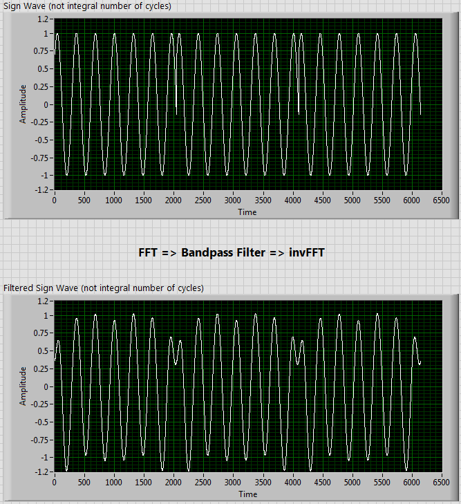

There is no compounding error with the FFT. It is doing exactly what it is supposed to do. An FFT assumes that the waveform is PERIODIC. If you do not have an integral number of cycles, you will get discontinuities between the end of one period and the beginning of the next. As altenbach said "you get spectral leakage and all kinds of artifacts"
 "Often times, I see a definite repeating pattern in the deviation from the correct amplitude."
"Looking at the inverse FFT reconstructed signal, there appears to be definite artifacts at the beginning and end of each analyzed segment of the signal."
Here is an example of doing an FFT=>bandpass Filter=>inverse FFT of a simple sine wave pattern with discontinuities before and after filtering. (p.s., FFT was done on a 2048 pt sign wave segment. The plots below show 3 concatenated segments )
I would go with the time domain filtering. Chunking up your data in groups of 2048 points will almost certainly give you discontinuities.
