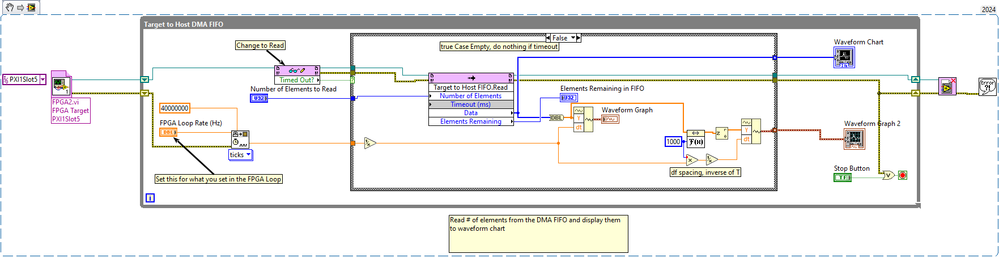

I looked over the host and some of the VI you have are not needed. You can hardwire the sample rate of the FPGA loop if you want, or you can continue to use the VI in the host, see below. The other VI is not necessary. You don't need to do anything about your function generator, the FPGA does not care. See if the code below helps for simple cases. Be sure to set the loop rate on your FPGA acquisition VI otherwise this will not work.

Yes, that is true and after removing some vis, it is working., mcduff,
I have gotten rid of the 'Sample Rate to Loop Time' vi and 'Normalize Signal Generation Parameters' vi and now I am getting a reasonable response.
Thank you very much.
