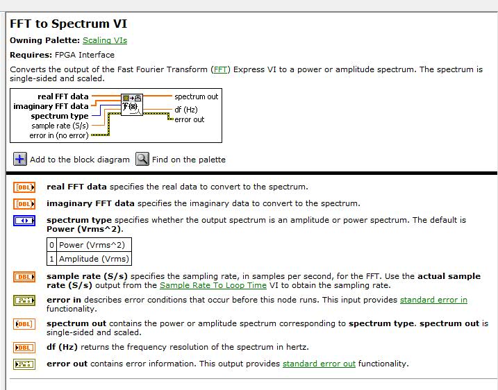

Hi Alexjdr,
The FFT to Spectrum VI that you are using on the host computer side outputs a single-sided (only positive amplitudes), RMS value.  If you want a double-sided, peak value then you would need to perform the appropriate conversions.  I'm inserting a picture of the LabVIEW Help file entry for this VI below.
Hopefully this information is helpful!

Hi Alexjdr,
The two VIs you are trying to compare function differently.  I recommend reading through the LabVIEW Help file entry for each one.  I believe you are looking for a power spectral density (PSD) measurement.  This is one of the options on the Spectral Measurements Express VI.  When selecting the PSD option, this VI "returns the FFT power spectral density and displays the results in RMS-squared per Hz units".  Again, this is not the exact units you are asking for, you would need to take the square root to get the units you are asking for.
The VIs you are looking at are essentially "functions" provided for you to use.  If they do not meet your needs, then you would need to write your own FPGA algorithm to perform the appropriate math that you need.
Josh B
