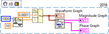

So you are playing a "single tone sound through a speaker" and analyzing it.  OK, here's a VI that generates a pure sinusoid (1000 points, 10 cycles, amplitude 1), converts it to a waveform sampled at 10KHz (your problem used 1400 points at 14KHz, but it's easier taking the reciprocal of 10K than 14K), and doing an FFT.

Here's the Front Panel (this is a LabVIEW 2016 Snippet, but you should be able to recreate this simple VI in LabVIEW 2014 ...).
Well, this (more-or-less) makes sense.  There seems to be a factor of 1/sqrt(2) in the amplitude plot, but this may well be the "intended behavior" (RMS and all that).  Note that the Phase makes perfect sense (do you see why?  Which point(s) have validity in that plot?).
I can't see what your microphone is giving you, but before you try out code on "real" data, be sure you understand how it should work on "data you control".

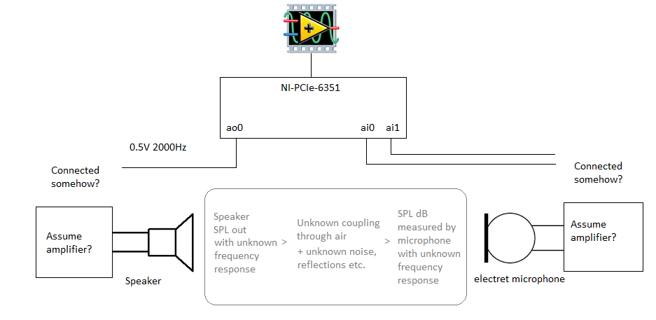

There seems to be a lot of assumptions and information missing in your setup and question.
From your description, this is what I assume your setup to be...
A "voltage" measurement is meaningless. The speaker, environment and microphone will all introduce distortions affecting your frequency response.  Bob is right.  Verify your code on clean sample data first, then start to look at your output and input stages.  Make sure you understand the maths, measurement units, scaling factors and conversions before trying to evaluate the magnitudes seen in your results.

Hello @TroyK
This is how my experimental setup look like
(5,734 Views)
What your drawing seems to show is three inputs from three microphones coming in on a single wire each (i.e. you are going in to the A/D converter in a "single-ended" configuration, with no indication of where anything is grounded).  Also, you show no connections to the D/A circuitry.  Do you need a course in basic Electronics?
