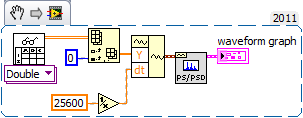

here  is my code... Q&D
feed the wfrm into the spectrogram vi ...
the resolution of your samples is not very high 😉
Greetings from Germany
Henrik
LV since v3.1
Message 6 of 8
(4,507 Views)

That's is a quick and dirty written vi.
For details hoover over the subvis, rigth-click and read the help 😉
