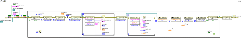

I am experiencing memory .NET reference leak. I have an third party hardware with C# dlls. It is simple measuring hardware with simple test VI: ( Init-> Config -> Start stream -> getting data in a loop -> stop stream -> close). Thing is that after a while my VI ends up with classic error 2: Out of memory. I am aware that C# references should be closed. I have used the DETT tool for detecting where the leak is located. DETT detects the .NET reference leaks. Unfortunately I am not able to locate the source of the error. Please could some1 have a look where the error could be located? I would be glad for any hint how to resolve or debug more precisely. The memory "overflows" in couple of hours, so obviously I suspect  the data stored in some .NET object, but this particular reference is closed everytime it is fetched.
that's an issue with this forum.
upload the .vi - if we should have a look.

Hope this simple .vi upload will help.
Error will happen at GetChannelData() .Net node in the while loop, but it will not popup, only if you place an simple error handler after the command. Otherwise the VI will run without any interuption for couple of hours and then it freeze.
