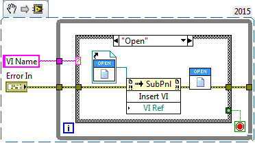

@Bob_Schor wrote:
 Here's an example:
Bob_Schor, two questions:
1. Why do you have the Open vi following the Insert VI invoke node?  Is this instead of invoking the Run VI method?  Is so, what is the benefit?
2. Wouldn't you need to invoke the Remove VI method prior to inserting the next vi into the subpanel?
Message 12 of 16
(877 Views)
Recall what we are doing.  We want to run a sub-VI (named "Open" in this example) and have its front panel show up in our Sub-Panel while it is running.  In this example, I simply run the sub-VI Open (I rarely use the Run VI method anymore -- if I want a detached VI, I'm more likely to use the Start Asynchronous Call), and while it is running, I can see its Front Panel.  Note if I reverse the order, then Open will run (but I won't see its Front Panel, and if it has a "Stop" button, I won't be able to push it), and when it exits, I'll open its Front Panel.  Oops, that's pretty useless ...
As to your second question, when we finish the code in the Snippet, i.e. when the sub-VI Open exits, the sub-Panel will continue to display Open's Front Panel until another VI's Front Panel is "Inserted" or, as you note, until we do a Remove VI (which renders the sub-Panel "blank").  I've got a project where there are 24 "clones" showing the results of 24 experimental Stations, and an control that lets me choose which set of 24 VIs I wish to display at any one time.  If I go from Station 1 to Station 2, I just do a different "Insert VI", but if I want to "turn off" the displays, I do a "Remove VI".
I hope that clarifies things.  The other thing you can do is to simply "try it yourself" and see what happens.  You could easily have answered both of your questions by simply writing a little simple LabVIEW code and trying it out for yourself ...
If you have more questions, please start a new thread (rather than hijacking this one).  Be sure to post your code so I (and other Forum Readers) can see what you are trying to do.
Bob Schor
Message 13 of 16
(863 Views)
