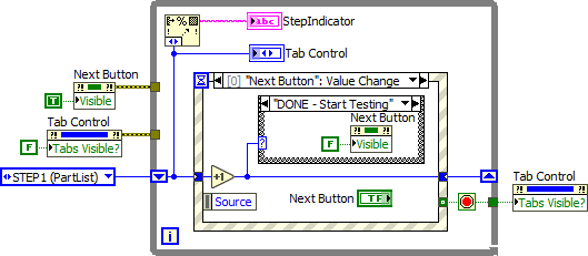

Please take a look at the attached vi.
The intent is to provide guidance through a sequence of steps. The last step presents a "Done" button instead of "Next".
The next button "floats" in front of the tab control. I make it 'disappear' when displaying the last tab so that the "done" button comes into play.
The trouble is that the done button does not act on / react to clicks when it gets displayed so the vi just hangs and never terminates - I have to shut it down the 'strong' way.
Why???

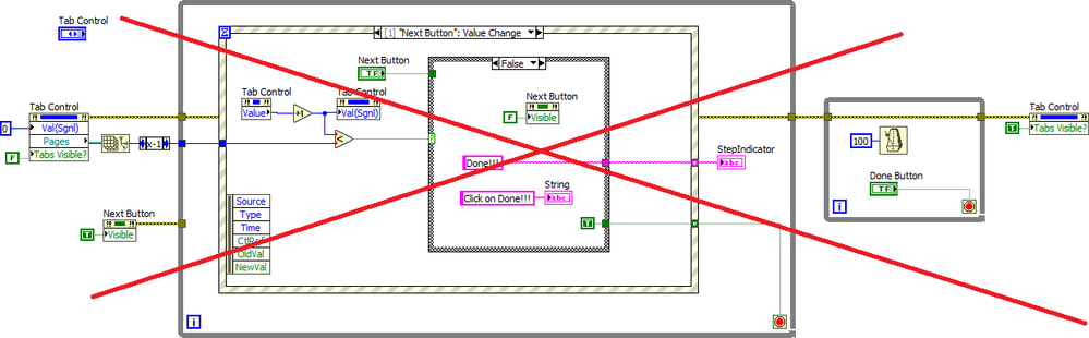

Because you fire a signaling event for the tab control but exit that loop and the event cannot trigger, but the event is set to lock the front panel until it can complete. Catch 22.
There are many other things wrong with this, I'll make a quick list later.

I don't have LabVIEW on this machine so can't look at your code, but the question that immediately came to mind is how are you making the floating Next button disappear? My guess is that this button is on top of the Done button. If this is the case then you would need to rearrange the buttons for the Done button to work.
Another option would be to just change the Text on the Next button to Done using a property node and use the same button.
  • You manipulate the tab control exclusively via signaling value properties. Make it an indicator and keep the value in a shift register.
  • Create an event for the done button, no need for that tail loop.
  • Why have a timeout case if it is not used?
  • etc. etc.

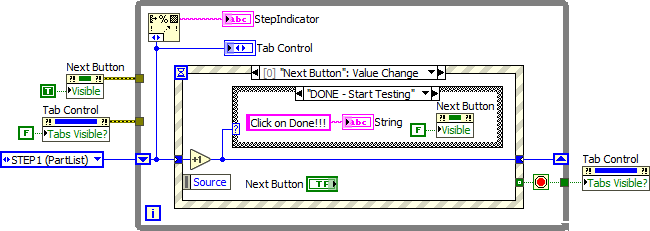

Here's a dramatically simpler VI that does exactly the same thing!
Maybe it can give you some general ideas how do do things less convoluted. Many improvements are still possible.
(1,049 Views)
Accepted by topic author GICA-VS_M
Note that your "string" (I can probably come up with a better name!) could just be a decoration on that tab.

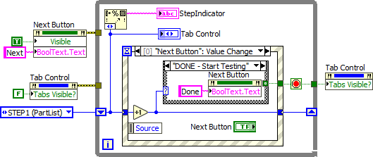

And, as has been mentioned, you could just change the boolean text of the button. and get rid of the done button entirely.
Here's how that could look like:
Now all we have is one single event! (Note that incrementing an enum (or tab) wraps around at the end.
