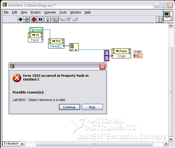

tst,
I think it was the FP Window origin in LV 7.x. Smiley Happy
See the attached pic. Correct/explain me if I my understanding is wrong.
- Partha ( CLD until Oct 2027 🙂 )
Message 9 of 11
(4,127 Views)
OK, whether or not it should have been a Panel class property or a VI property is a good question and the answer could probably go either way, but the concept remains the same - when there were no panes, there was a single origin. With panes, each pane can have its own origin.
