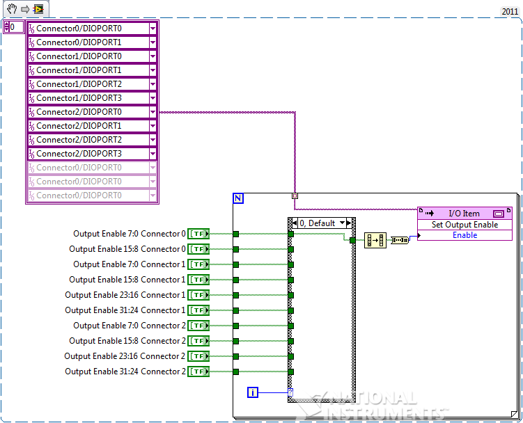

I have some code I need to perform on an I/O resource on the FPGA.  I need to perform this same code for several I/O resources.  So I thought I would be clever and create an array of references, (set array size of course) and then iterate over the array performing my code.  The problem with this is I get an error causing a broken arrow.  The error is Possibility of Dynamic Refnum not supported for the current target.  It states that Refnums must be constant references.  Looking at my code my reference are a constant.  I also tried taking the array of references into the for loop, and indexing them but this also caused the same error.
Why can I not index an array of I/O references? which are a constant?  Is it because I could potentially perform a replace array element, and now my I/O Item will be performed on another resource?
At the moment the work around is to create 10 reference constants, and pass them into the for loop one at a time (similar to the case structure and booleans).  Thanks.FPGA Error.png
EDIT:  Actually my "work around" doesn't work either because the input still changes.  So I guess I'll need to duplicate my code in 10 places, unless anyone has any suggestion.

Unfortunately this use case is not supported by LabVIEW FPGA (yet). Clusters of reference constants are supported if that makes the code cleaner as you pass values around. The compiler will not currently unroll a loop that has method or property nodes in it, so unfortunately your best bet right now is to put that code in a separate VI and then instantiate N copies of it for each reference/boolean array pair.
