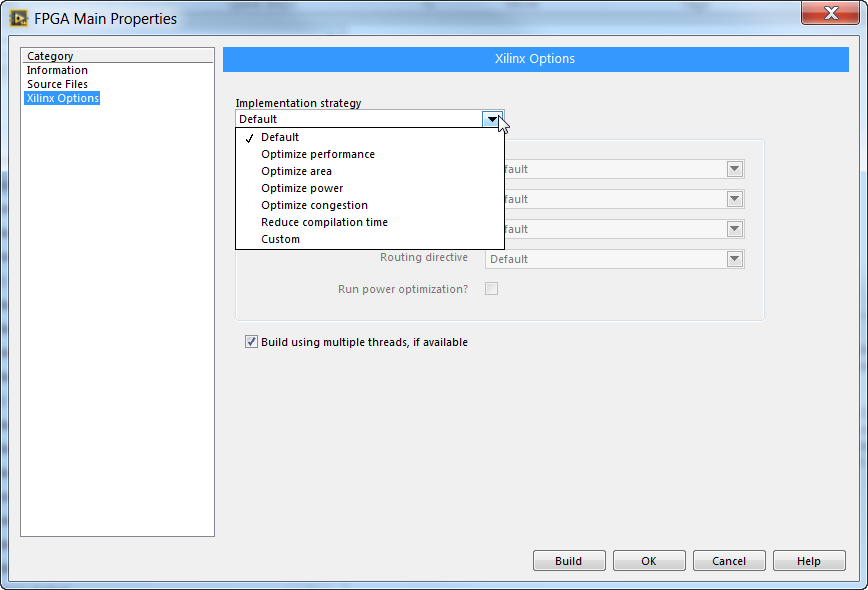

The only options I'm aware of are the ones that you can specify in the FPGA build specification:
(blog)

That is with LV2014 SP1 for a cRIO-9066 - a similar page exists in older versions for cRIOs. I've never used a FlexRIO so I don't know what differences there are.
(blog)

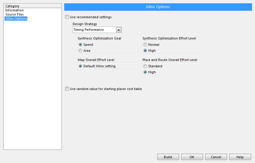

In LV2012 for the Virtex-II I have these options:
Virtex-II Compiler Options
For the FlexRIO (7965R) there's no Xilinx options tab.
Message 10 of 16
