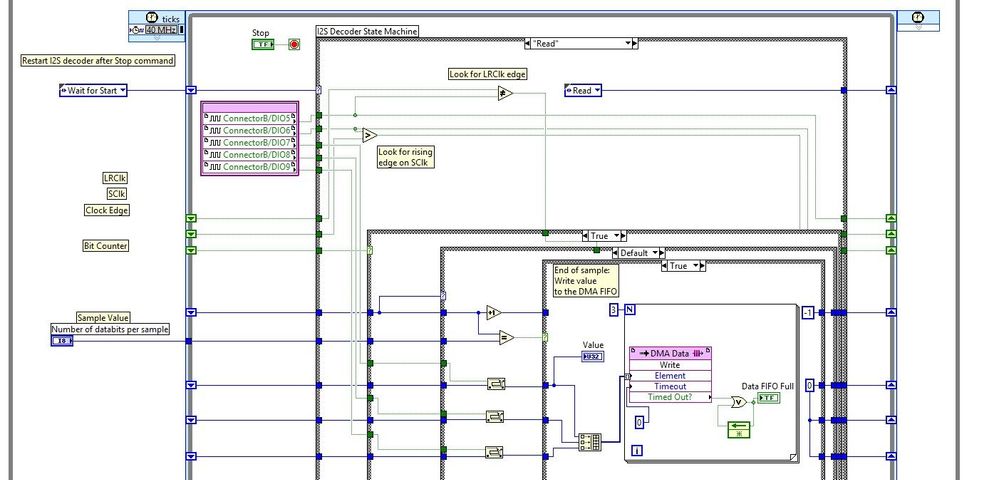

I need to transmit an array contain three elements, so I should use For_loop for FPGA_FIFO, knowing that I used timed loop when I build FPGA code an error shown that "You cannot include this function in a For Loop when the For Loop is inside a single-cycle Timed Loop."
any help!!
FPGA screenshot

They simply aren't supported as every loop in LabVIEW FPGA requires mutliple cycles to complete (except the single-cycle loop!).
For many things you might just manually duplicate the code but in your case you won't be able to as you won't be able to write multiple times to a DMA FIFO in an SCTL.
You have two options:
1. Remove the SCTL as GerdW suggests.
2. Create a new intermediate FIFO which takes all 3 elements as a cluster or similar. This writes to a standard loop which can send them sequential up the DMA FIFO in a seperate loop. This is how I have handled this case in the past if you need the SCTL (I suspect you might by the code comments)

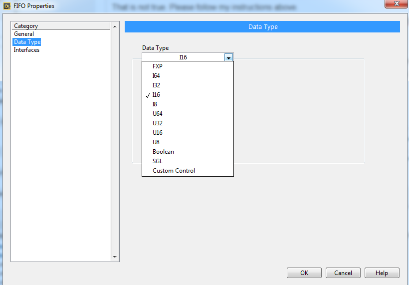

This must be a Target Scoped FIFO, please confirm that.
Create a typedef which is a fixed size 1D array of U32.  Edit or make a new Target Scoped FIFO and in the datatype it will have an option for Custom Control (last one I think).  Select that and then browse to this new typedef.

That is not true. Please follow my instructions above.
See the LabVIEW FPGA 2016 help: http://zone.ni.com/reference/en-XX/help/371599M-01/lvfpgadialog/fpga_data_type_db/
See:
  • Custom Control—Opens a dialog box in which you can navigate to the custom control you want to use. This button appears only when you select Custom Control in the Data Type pull-down menu.
See image below:
