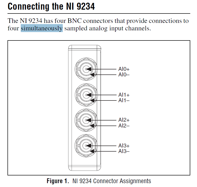

I checked out the specifications of the module NI 9234, as in the following figure.
As shown, for this module, all the four channels are sampled simultaneously.
Now I'm sure!
I think for every module, we should check out the specifications to make sure.
