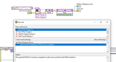

I have access to a program that uses NI CRIO.  But the program is showing an error. And I am new to FPGAs in general as well as in labview.
It is showing FPGA VI not compiled. I tried googling how to compile FPGA VIs and it is showing that we can click the run button and the compile window pops up. But I cant click run button because of broken arrow. How do I fix this. To let you know, this program was not written by me. Its not even present in my PC. Its in a remote PC in a different continent and FPGA is connected to that PC. Anyway labview is detecting the FPGA. So that is fine. But i cant compile this.

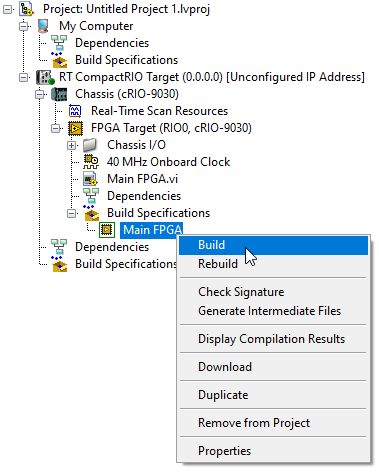

You can compile FPGA VIs the same way as you compile VIs for Windows or Realtime targets (like cRIO): you create a BuildSpec in your LabVIEW project in the subtree of interest (MyComputer, Realtime, FPGA), then you right-click this BuildSpec and choose "Build"…

In you current case, you are opening a reference to the FPGA VI using the FPGA Interface from your (RT) host target.
What you need to do is find the associated build specification under the FPGA target and build it:
